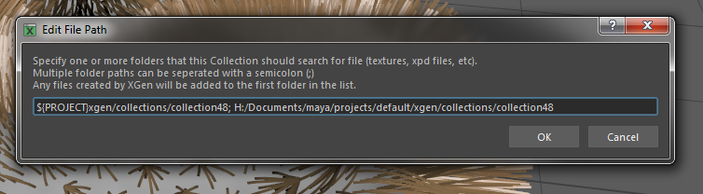

  1. In the XGen window, go to Collection > Edit File Path.
    The Edit File Path dialog box appears.
  2. Enter the desired path names separated by semi-colons. You can add a mix of absolute and relative paths.
  3. Click OK.
XGen will search each location in turn until it finds the required files. If no appropriate files are found, it returns an error that is recorded in a log file.
