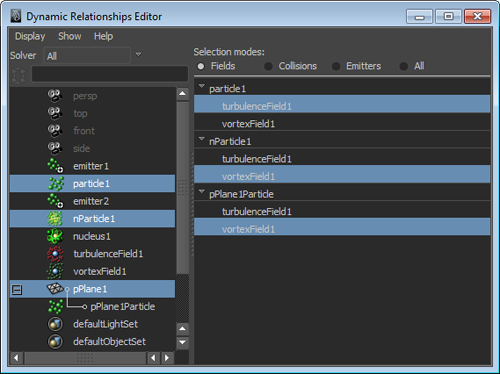

    The fields that are currently connected to the particle object are displayed highlighted in the right panel under particle1. Also, the fields that can be connected to the soft body and nParticle objects are listed under pPlane1Particle and nParticle1. By default, when you select soft body objects in the left panel, the object displays in the right panel with its associated particle object appended to its object name.
  4. To connect the Vortex field to the soft body and nParticle objects, click vortexField1 under pPlane1Particle and nParticle1.
    The Vortex field is now connected to the soft body and nParticle objects.

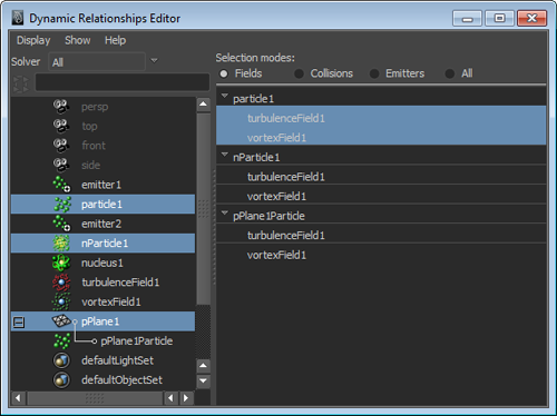

  5. To disconnect the Vortex field from the particle object, under Particle1, click vortexField1.
    The Vortex field is disconnected from the particle object.
