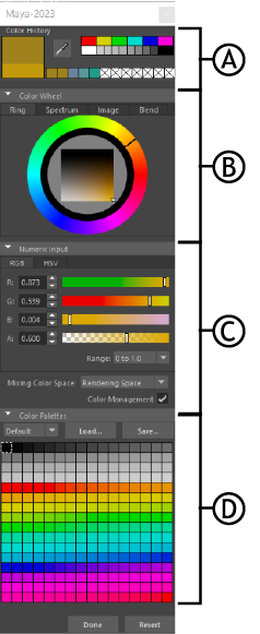

The Color Chooser is the common tool for managing colors in Maya.
To open the Color Chooser
- Double-click a color swatch anywhere in the Maya interface
Full Color Chooser window: A. Color History area, B. Color Wheel, C. Numeric Input area, and D. Color Palettes.

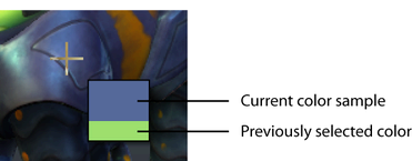

- Eyedropper
Use the Eyedropper tool to select a color from any screen pixel and apply it to an object in your scene. Click the Eyedropper icon
, then click anywhere, including in the
Color Chooser, to change the current color selection.
The swatch under the cursor indicates the current color sample, and the previously selected color.
Exit the Eyedropper by pressing Esc, scrolling the mouse wheel, or switching tools (without clicking, for example, Alt + Tab).

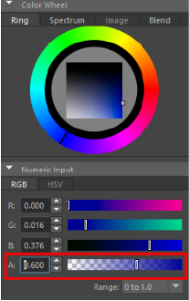

- Alpha Channel
- Some elements in
Maya interface
Color Settings support alpha channels, which let you affect the color opacity. If an alpha channel is available, it appears in the
Numeric Input
RGB or
HSV color models as a channel with an
A.
Color Chooser with Alpha channel
- To see what element colors are available with an alpha channel, see the Color Settings topic Active and Inactive sections Set wireframe transparency.
