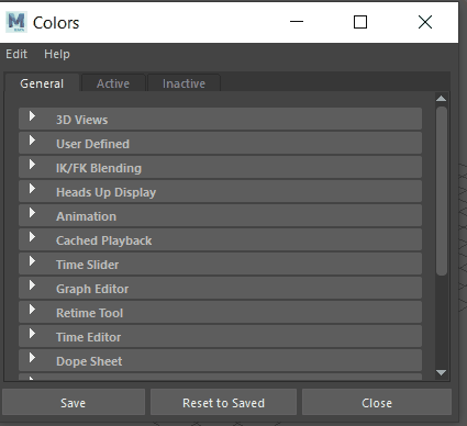

  1. Open the Color Settings window.
  2. If the color you want reduce opacity on is a selected object, click the Active tab, if it isn't, click the Inactive tab.
    In this example, the polygon is not selected, so we select the Inactive tab, expand the General group, and double-click the Polygon Surfaces color tile.

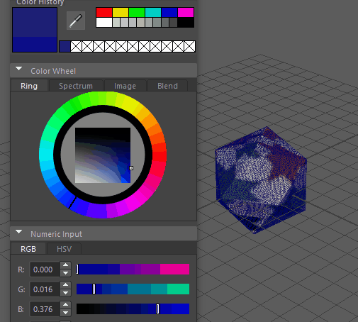

    This opens the Color Chooser.
  3. In the Color Chooser, go to the Numeric Input area. The Transparency setting is represented by an A (for Alpha channel). Move the slider to change the amount you'd like to reduce the opacity of the wireframe.
  4. Click Done.
