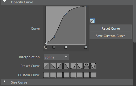

Curve grid
Click anywhere on the curve to insert curve points. To move points, drag them.
Curve Delete Handles
Click the corresponding Delete Handles under the Falloff Curve grid or Ctrl + click on the point on the curve.
Expand Falloff
Click next to the Falloff Curve to open a larger Falloff Curve editing window.
To help you distinguish between points that are close together on the curve, the delete handles display in shades of grey. The darker the delete handle, the higher the point on the Y-axis.
Reset Curve
Resets the falloff curve to its default shape.
Save Custom Curve
Saves the current falloff curve to the Custom Curve presets in the Tool Settings.

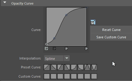

Opacity curve
Turn on Enable Tablet Pressure for Opacity in the Blue Pencil Tool Settings to use the Opacity curve to set how the Blue Pencil stroke acts. Instead of a uniform thickness, you can vary the opacity, for example to create a soft start and then increase the intensity of the stroke dramatically.
Note: The Opacity Curve is only offered for the Blue Pencil Brush tool, it is not offered for the Pencil or Eraser.
Size Curve
Turn on Enable Tablet Pressure for Size in the Blue Pencil Tool Settings to use the Size Curve to create a variable size for the Blue Pencil stroke.
Note: The Size Curve is only offered for the Blue Pencil Brush and Pencil tools. It is not offered for the Blue Pencil Eraser.

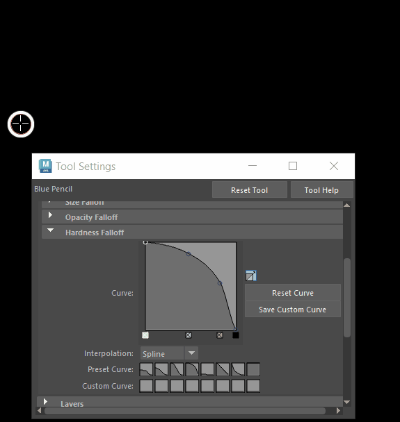

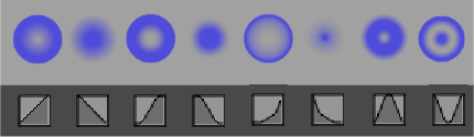

Hardness curve
Hardness curve presets
Use the Hardness curve to create stroke with varying definition: the degree of hardness affects whether your brush is sharp or blurry.
Note: The Hardness curve is only for Blue Pencil Brush and Eraser tools, it is not offered for the Pencil.

Hardness curve
