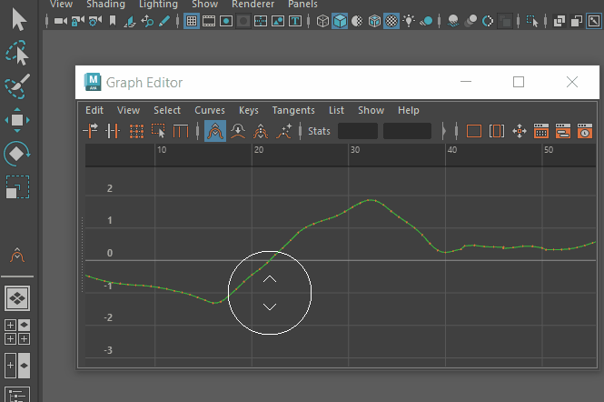

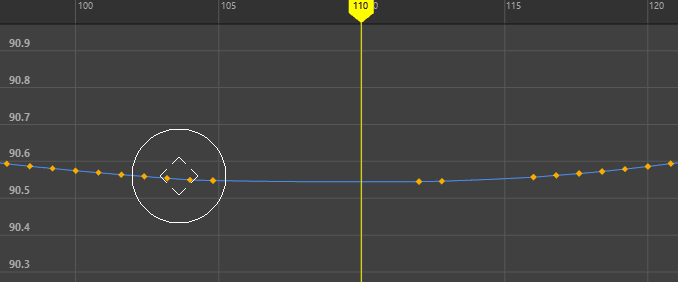

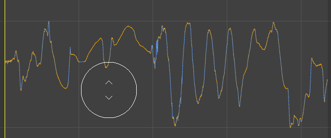

Activate this option to sculpt curves on both the Graph Editor Value and Time axis. The sculpt brush cursor changes to reflect whether you are in Value or Value and Time modes.
Left: Value only (default) cursor. Right: Value and Time cursor.
Grab Curve Sculpt tool with Affects Time active
Smear Curve Sculpt tool with Affects Time active

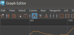

Push keys up or down in the Graph View Select the Grab tool from the Graph Editor toolbar. You can also find the Grab tool in the Graph Editor Edit > Sculpting Tools menu.
Flatten keys on a curve in the Graph View Select the Smooth tool from the Graph Editor toolbar and drag over the curve you want to affect. You can also find the Smooth tool in the Graph Editor Edit > Sculpting Tools menu.
Spread keys on a curve in the Graph View Select the Smear tool from the Graph Editor toolbar and drag over the curve you want to affect. You can also find the Smear tool in the Graph Editor Edit > Sculpting Tools menu.
Lessen keys on a densely-keyed curve Select the Key Reducer tool from the Graph Editor toolbar and drag across the curve you want to reduce. You can also find the Key Reducer tool in the Graph Editor Edit > Sculpting Tools menu.
