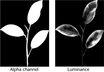

You can import image files created in other programs and use their alpha channel values or luminance values as attribute maps. The alpha channel is the channel in an image that contains the opacity information. Not all images have an alpha channel. Luminance refers to the intensity or brightness of the image.
Attribute map values are represented by grayscales, with black representing a value of 0 and white representing a value of 1.

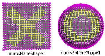

For example, suppose you create the following two surfaces and export the attribute map, calling it xando.
Artisan creates two files, xando_nurbsPlane1_nurbsPlaneShape1 and xando_nurbsSphere1_nurbsSphereShape1. It saves the attribute maps separately for each surface in these files.
To import these maps back to the same surfaces, follow steps 1 through 6 in the above procedure, "To import an attribute map". For step 7, import either the base file (xando) or one of the files associated with the surface (xando_nurbsPlane1_nurbsPlaneShape1 or xando_nurbsSphere1_nurbsSphereShape1). Artisan automatically maps each file to the appropriate surface.
