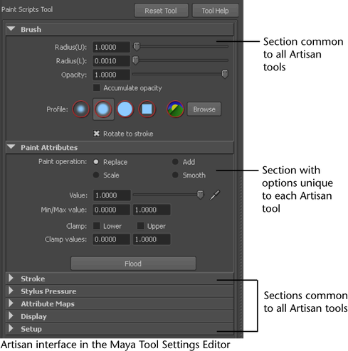

Many brush tools in Maya use the Artisan interface. These tools are called Artisan tools. Artisan tools let you manipulate your geometry in a more artistic manner by allowing you to paint their values and properties with the brush tool.
Artisan BrushTool Settings
Artisan uses the Maya Tool Settings editor to set tool properties. All Artisan tools share common options, which are described in Artisan Tool Settings.
For each Artisan tool, the Tool Settings editor contains a section with settings that are specific to that tool. This unique section appears after the Brush section and its unique settings are described where the tool is described, as follows:
