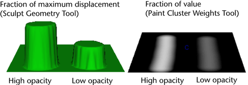

Brush opacity
Brush opacity refers to the fraction of the maximum displacement or brush value (depending on the selected tool) to apply to each brush stamp within a stroke.
Brush values
Brush value refers to something different for each Artisan tool. For example, for the Paint Cluster Weights Tool, value refers to vertex weight. For the Paint Fur Attributes Tool, it could refer to the amount of curl.
