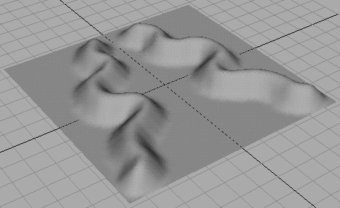

You can set Artisan tools so that your brush strokes are mirrored or reflected along the axis of your choice as you paint. This is useful when you want to create a symmetrical effect. For more information, see Stroke section in Artisan Tool Settings.

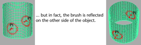

Note: When you reflect paint on a surface, it may appear as though the reflection is not symmetrical...
Reflection is through the X, Y, or Z axis, based on the center of the selection's bounding box, or through the origin, depending on the settings you choose.
