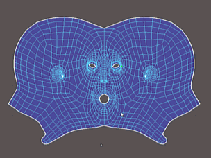

To open the Smear UV Tool, select it from the Transform > Tools section of the UV Toolkit or select Tools > Smear from the UV Editor menus.
The Smear UV Tool moves UVs in a direction that is tangent to their original position on the surface in the direction you stroke.
