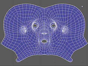

The Pinch UV Tool pulls UVs in towards the center of the tool cursor, making the texture take up less space on the model. Press Ctrl to push UVs away from the center of the cursor, creating the inverse effect.
