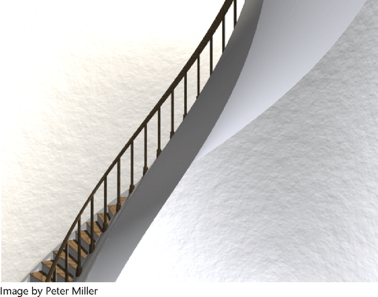

Example Twist Deformation: Modeling a Spiral staircase.
The foundation, rail, and moldings of the staircase’s model were shaped with the twist deformer.
