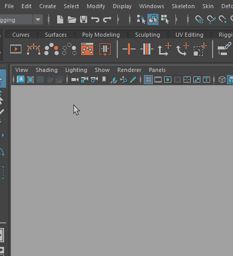

There are seven menus always available in Maya: File, Edit, Create, Select, Modify, Display and Windows.
All other menus change depending on the menu set you select: Modeling, Rigging, Animation, Dynamics, Rendering. Each menu set is designed to support a particular workflow.
You select the menu set you want to work with from the drop-down list in the Status bar.
