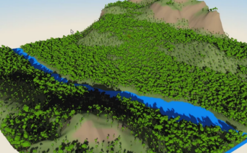

Terrestrial Ecosystem
Specifies the parameters of a Terrestrial Ecosystem-based Cluster Mode. When simulated, the starting points are treated as seeds, which age into plants, which sew new seeds, etc.
Ecosystem Age
Determines the number of years to simulate the aging/seed dropping process.
Maximum Elements
Determines the maximum number of seeds allowed in the ecosystem at one time.
Seed Multiplier
Multiplier for the number of seeds that each object can sew.
Genotype Editor
Opens the Genotype Creator, which allows you to modify the attributes of each seed type in the Attribute Editor.
Ground Mesh
Specifies the parameters of the ground mesh on which the simulation takes place.

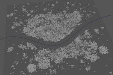

Maps
Use Genotype Map
Allows you to assign starting seed positions to the landscape using a 2D map. Genotypes of a specific ID color (as assigned in the Genotype Creator) will begin in areas of the same color on the map.
Genotype Map
Specifies the map used to assign IDs.
R: Temperature, G: Soil Quality, B: Moisture
Determines whether or not to include the respective factors into the simulation (represented in the ID map by the colors Red, Green, and Blue).
Conditions Map
Specifies the map used to assign Temperature, Soil, and Moisture.
Output Age as Time
Outputs plant ages into the time channel, allowing you to assign animation frames depending on the plant age. Useful for time-lapse animations.
Time Range
Determines the time range used when Output Age as Time is enabled.
Round Time
Rounds the value output by Output Age as Time to the nearest whole number.

Avoidance
Allows you to specify objects for cluster points to avoid. Compatible objects include polygon meshes, NURBS and bezier curves, and other MASH networks.
Note: If you find points moving in unwanted directions when avoiding, use an Input Mesh to limit their movement to a surface.
Avoidance Radius
Specifies the area around the avoidance objects for points to avoid.
Note: If points still spawn within the Avoidance Radius, you will need to widen the left side of the Avoidance Ramp.
Avoidance Ramp
Determines the falloff strength and shape of the Avoidance Radius. The graph represents the likeliness of a point spawning from the edge of the Avoidance Radius (left side) to the avoidance object itself (right side).
Objects to avoid
Lists the objects currently being avoided by cluster points. You can middle-drag objects into this field to add them, or right-click to connect the selected object. You can also right-click existing objects to remove or show them in the Outliner.
