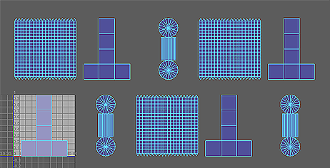

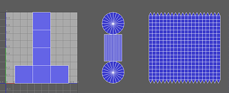

UV Tile Settings
- UV Mode

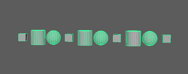

- Determines the UV space for each mesh in the MASH network. For example, given the following MASH network
The available options would appear as follows:
- Pass Through
- UVs are placed in the same space as their source object, even if this means they overlap in 1,1 UV space.
- By ID
- The UVs corresponding to each object with a unique ID are placed side by side. UVs corresponding to objects with the same ID will overlap.
- Unique
- The UVs corresponding to every individual object are placed side by side.
