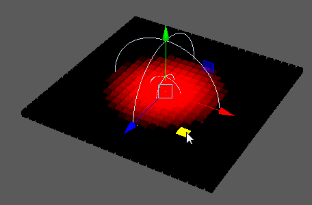

Creates and controls a falloff volume using an input object for its shape.
Note: The falloff node is not available for manual creation via the Waiter's Add Node field. Instead, you can create it via the Attribute Editor's Falloff Object section of appropriate nodes.

Shape
Sets the shape of the falloff area. Options include:
  • Sphere: A gradient from the center to the edges of a sphere.
  • Cube: A gradient from the center to the edges of a cube.
  • Nurbs curve: A gradient along a curve.
  • Particles: A gradient defined by the position of dynamic particles.
  • Mesh: A gradient along a custom mesh shape.
