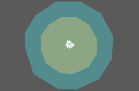

This allows you to change the diagnostic display shown in the viewport.
Display Type
Determines what the display in the viewport represents. Options include:
  • Normal: Displays the Alignment Zone (green) and Separation Zone (blue)
