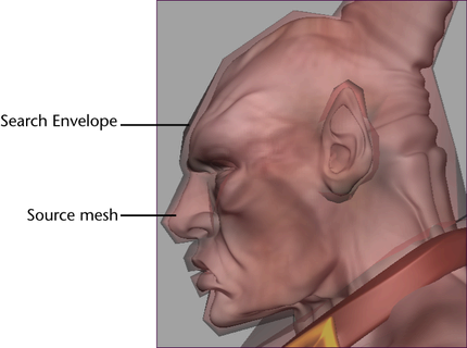

Search Envelope (%)
The search envelope is a user-editable piece of geometry that defines the search volume or threshold of the transfer map generation operation.
This attribute sets the size (%) of the target meshes’ search envelope. If you set the Search Envelope to 10, then the size of the envelope will be 10% larger than its target mesh.
You can edit the search envelope’s vertices to fine tune its shape and coverage.

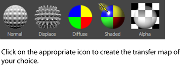

Output maps
Select a map type from the list of icons available. The section for the selected map type appears. You can create as many maps as you need.

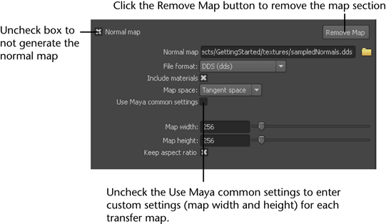

Note: In each section, you can:
  • Uncheck the box beside the map type (for example, Normal map) to remove it from the list of maps to generate;
  • Click the Remove Map button to remove a map from the list of maps;
  • Check the Use Maya common settings options to honour them;
  • Uncheck the Use Maya common settings options to enter custom settings for each transfer map.
Your settings (for example, the map sections that you have created and checked) are saved with each session of Maya.
Normal map
Normal maps capture the surface normal information of the source meshes. The texture is sized and positioned depending on the UV parameterization of each mesh.
When on, a normal map is generated. Enter the filename and path to which you want to save the map.
Creating and applying a normal map to a surface allows a lower density surface to include finer detail, giving the appearance of a much higher density surface.
Note:
  • You can render left handed tangent space normal maps. For more information regarding the left handed tangent space, see Tangent Space.
