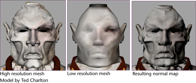

To create a normal map using the Transfer Maps editor’s default settings
- Load your source and target meshes into a new Maya scene.
- Make sure that your source and target meshes are positioned on top of each other in the scene view.
- Select your target mesh in the scene view.
- Select Lighting/Shading > Transfer Maps.
The mesh you selected is automatically loaded as a Target and all other meshes in your scene are loaded as Sources.
- In the Output Maps section, click on Normal from the list of icons to create a Normal map.
- Set the following attributes in the Normal map section:
- File name (Normal map field)
This determines the name of the texture map file as well as where the map will be saved.
- File format
This determines the file format of the normal map you generate.
- Map Space
Select Tangent Space.
- Check the Use Maya common settings option so that you can share and reuse your settings when you create more than one map with the same width and height.
- Scroll to the Maya Common Output section and expand the section to set your common map attributes. Set the following options:
- Map width and Map height
This specifies the resolution for the texture map.
Note:The Maya scene view only supports tangent space maps and they are only visible in the scene view when in High Quality Rendering mode.
- Select a medium Sampling Quality.
- Select World Space in Transfer in.
- Keep the rest of the options at their default settings.
- Scroll to the Connect Output Maps section to specify how the texture map you are going to create will be linked to the target mesh. To view the results of the texture map within Maya, enable Connect maps to: New shader /Connect maps to: Assigned shader.
- Bake the normal map.

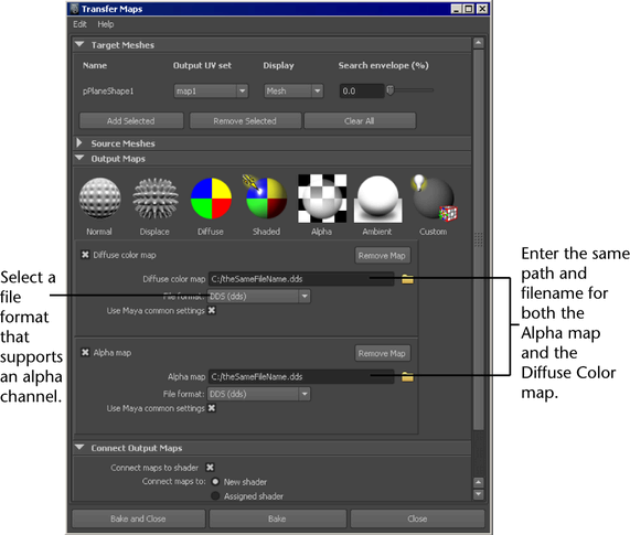

To create a texture map with an alpha channel
- Transfer maps allow you to pack any scalar output (for example, alpha or displacement) into the alpha channel of the texture map being used for a vector output (for example, color or normal). Therefore, you can create, for example, a color map with alpha, or a normal map with displacement, or a color map with displacement, and so forth.
- Select a file format that supports an alpha channel (for example, .dds, .exr, .tif).
- Enter the same path and file name into the two output you want to combine into a single texture map. The path and file names are case sensitive.
- Bake the map. Note:
If the Connect maps to shader option is enabled, Maya attempts to connect the combined map to the shader. However, many of the combinations that are generated using this method require a custom (hardware) shader for correct display in the scene view.
