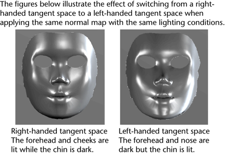

By default, Maya uses a right-handed tangent space. That is, the normal, tangent, and the binormal form a right-handed coordinate system.
However, if you are working in an environment that requires a left-handed tangent space (for example, the game engine you are using mandates that you use a left- handed system, or you are incorporating normal maps into your scene from other applications that are based on a left-handed system), then setting this option to left-handed ensures that the tangent space is calculated so that the normal, tangent, and the binormal always form a left-handed coordinate system.
Note:
By default, Autodesk® 3ds Max® uses a left-handed tangent space. Therefore, when you are incorporating normal maps from 3ds Max, you should make sure to select the Left Handed option in the Attribute Editor of the polygon mesh. Alternatively, you can also go to Windows > Settings/Preferences > Preferences > Modeling > Polygon Tangent Space and set the Default co-ordinate system to Left handed so that all new meshes use left-handed maps by default.

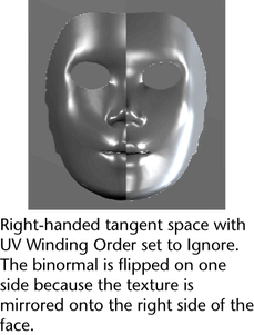

In situations where the UV winding order of a face is reversed (that is, counter-clockwise), a straightforward left or right-handed tangent calculation results in a flipped binormal.
By selecting the UV Winding Order Detect option, Maya will calculate the binormal based on the V direction of the UV mapping.
Tip: The UV Winding Order Detect option is set by default for any new meshes you create. In most cases, this option should allow your normal and bump maps to be displayed correctly.
