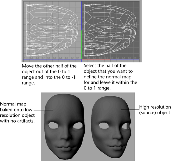

- Set the UV Winding Order of your object to Detect to ensure that both sides of your mirrored normal map are displayed correctly. For more information about UV Winding Order, see UV Winding Order.
- Select the half of the object (for example, face) that you want to define the normal map for. Leave this half within the 0 to 1 UV range.
- Move the other half of the object out of the 0 to 1 UV range so that it does not affect the generated normal map.
- Bake the normal map using

Creating and displaying a mirrored normal map on a character or object: Option 2
- Select Lighting/Shading >
Transfer Maps and enable the
Ignore Mirrored Faces option under the
Maya Common Output section. See
Ignore Mirrored Faces for more information.
