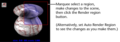

If you turn on Auto Render Region (Options > Auto Render Region), the changes you make appear as you draw the marquee anywhere in Render View. Only the marqueed area of the surface re-renders showing the results of the adjustment.

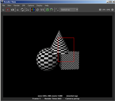

To render a region of your scene
- Marquee select the area that you want to render in Render View.
- If there is no representation of your scene in Render View for you to marquee select Render > Snapshot > and select the camera (view) you want to capture.
- Click the
Render region button
or select
Render > Render Region.
