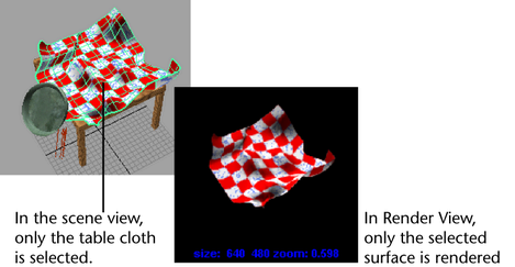

To render selected surfaces
  1. Select the objects you want to render.
  2. In the Render View window, select Render > Render Selected Objects Only.
  3. Render the scene.
