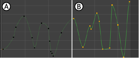

    Note: When an animation curve is referenced, it appears dimmed (40% of the original curve color) with black locked keys.
    Animation curve in the Graph Editor: A. Referenced locked, B. Referenced, unlocked
