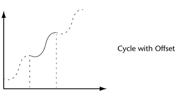

- Cycle with Offset
The Cycle with Offset setting repeats the animation curve infinitely, except it appends the cycled curve’s last key’s value to the value of the first key’s original curve.

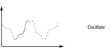

- Oscillate
The Oscillate setting repeats the animation curve by reversing its values, and therefore shape, with each cycle, creating an alternating backwards and forwards effect.

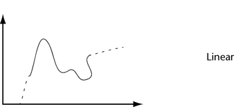

- Linear
The Linear setting extrapolates the value of the first key using its tangent information. It projects a linear curve infinitely beyond.

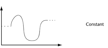

- Constant
The Constant setting maintains the value of the end keys. This is the default setting for animation curves in Maya.

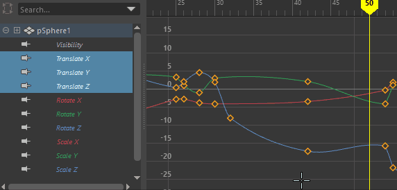

- Isolate Curve
When on, only selected curves display in the graph view area and all other curves are hidden.
For example, to focus on only the Translate Y curves of several objects at once, select either the Translate Y curves in the graph view or the Translate Y channels in the Channel Box, then enable Isolate Curve. All other curves are hidden and you can easily edit the Translate Y curves alone.

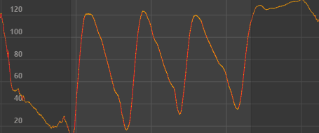

- Smooth Filter (Butterworth)
Note: Previous versions of Maya referred to this filter as Butterworth Filter. It has been renamed Smooth Filter (Butterworth) for clarity.
Smooth Filter (Butterworth) averages key frames using intelligent low-pass smoothing. It is a frequency filter that works best on curves affected by noise.

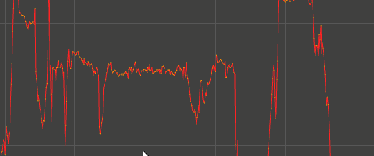

The Smooth Filter (Gaussian) is similar to the Smooth Filter in Autodesk MotionBuilder. Use the Smooth Filter (Gaussian) to apply linear filtering to reduce noise on keyframe channels.
Smooth (Gaussian) filter applied to one channel

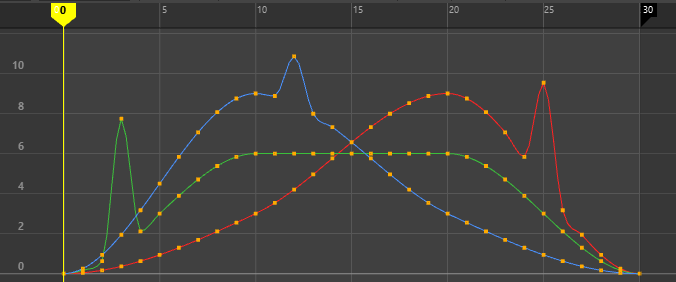

- Peak Removal Filter
The Peak Removal Filter replaces unwanted peaks and spikes in animation data with cubic keys that have an average value based on the neighboring keys. Use the Peak Removal filter to clean, or modify motion capture data, especially in cases with magnetic capture systems that generate localized distortions caused by occluded markers that require you to manually tweak the captured data.
Peak Removal Filter: Preview of Filter All and Selected options

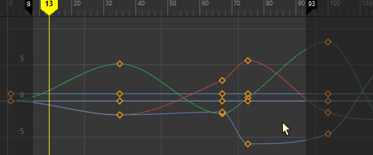

- Key Sync Filter
Set a key on one curve, and the Key Sync filter adds a key to the other curves
- Adds a keyframe to all curves (X, Y, Z) for each key that is encountered. For example, if an object has a keyframe set on its X animation curve, a keyframe is set on its Y and Z translation curves at exactly the same time. This lets you synchronize all keyframes on each of the object’s animation curves.
