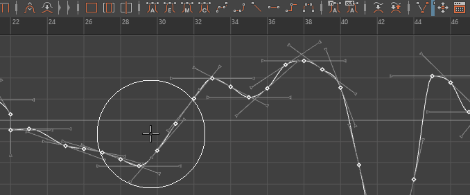

View curves while editing
Using a Buffer Curve to view the effects of the Smooth Curve Sculpting tool.
To view the original and result animation when editing curves
  1. Before editing the curve, select it in the Graph Editor.
  2. Do one of the following:
    • Select Curves > Buffer Curve > Snapshot from the menu bar.
    • Click the Buffer Curve Snapshot button in the toolbar.
      Note: Turn on View > Simple Toolbar if you do not see this icon.
    A gray curve representing the current curve appears in the graph view.
  3. Edit the colored curve.
  4. You can switch between the edited curve and the original curve (buffer snapshot) by clicking the following:
    • Select Curves > Swap Buffer Curve from the menu bar.
    • Click the Swap Buffer Curve button in the toolbar.
