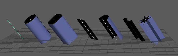

Default Poly, Rectangle, Line, Arc, Wave, and Custom sweeps created from a simple diagonal line
Sweep Mesh lets you generate a polygonal mesh from a simple curve shape.

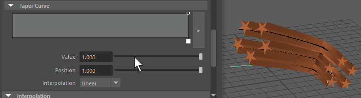

- Taper
- Increase or decrease the scale of the profile along the path relative to starting scale profile value (value of 0 will scale down to a point at the end of the path).
- Taper Curve
- Add control points in the Taper Curve ramp UI to create a variable taper along the length of the sweep path. A multiplier of the attributes Scale Profile.
