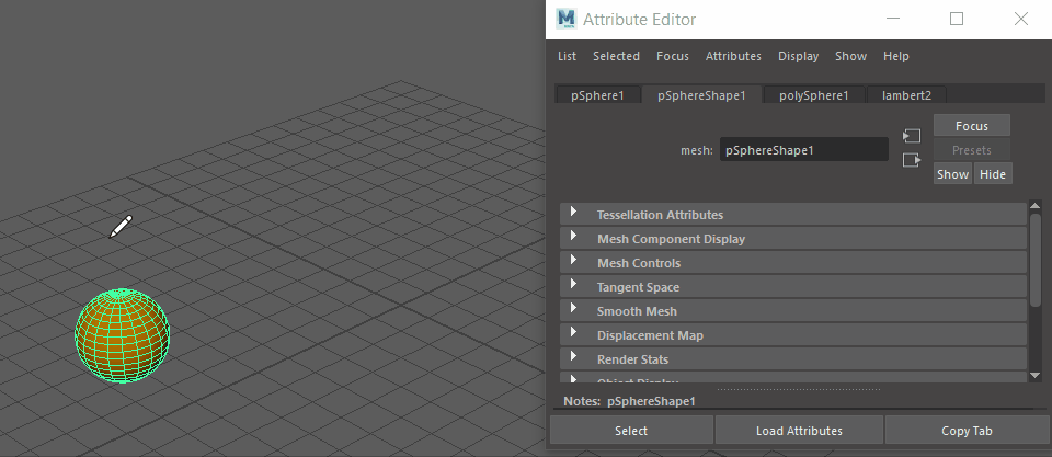

- Create a sphere. ()

- In the
Custom Sweep Profile dialog, set
Type to
Poly Face and select a face on the sphere. That face sweeps along the curve.
