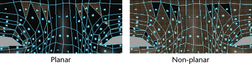

- Planarity
Select either planar or non-planar faces.
- Planar/Non-planar
Planar selects only planar faces. Non-planar selects only non-planar faces.

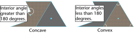

- Convexity
Select polygons based on the angle of their sides.
- Concave/Convex
Concave selects polygons that have at least one interior angle greater than 180 degrees. Convex selects polygons whose interior angles are all less than or equal to 180 degrees.

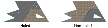

- Domains
Select faces based on whethe they have a hole or not.
- Holed/Non-holed
If you select non-holed, only faces that do not have holes are selected. If you select Holed, only faces in which holes have been created (using ). For more information, see Make Hole Tool Options.
Note: Maya considers faces with holes to be concave.

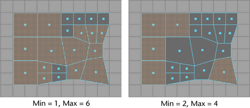

Min and Max values
The Min and Max values for most of the Geometry options correspond to the units of a polygonal face. The values you set constrain the selection to the size of the face that corresponds to those units. The default unit size is in centimeters by default. You can change this in the Preferences window (Windows > Settings/Preferences > Preferences, then click the Settings category).
In this example, each face of a polygonal primitive plane is four units. You can determine this by looking at the squares of the grid within each face.
When you scale some of the faces and subdivide others, the topology changes as do the Min and Max values you can enter to constrain the selection area.
Try setting different Min and Max values for the Area option for faces, for example, to determine which faces fall within the Min/Max criteria determined by the unit size.
If you set the Area criteria to a Min value of 0 and a Max value of 7, all faces are selected because there are no faces with a unit area less than 0 or greater than 7.

Area options for faces
Maya selects the faces with an area that is within the range specified in the Min and Max boxes. See Min and Max values for details about using these values.

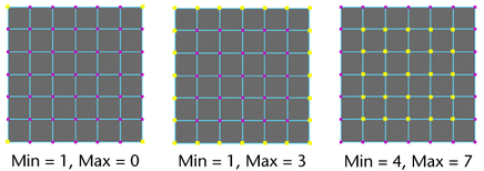

Neighbors options for vertices and UVs
Maya selects the vertices with no fewer than the Min number of edges connected to them and no more than the Max number of edges connected to them.
