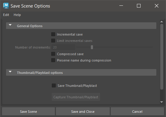

Use these options to set what happens when you select File > Save Scene. See also Create, open, or save a scene file.
General Options
Incremental save
Activate Incremental Save to create a backup folder by the same name in the scenes\incrementalsave folder. Each time you save, another backup file is created. These backup files are incremental (filename.001.mb, filename.002.mb) so the previous backup is not overwritten. The number of incremental backups created is infinite by default.
Limit incremental saves
Applies a limit to the number of incremental backup files that Maya creates and stores. The default limit is 20 increments.
Number of increments
Type a value or drag the slider to specify a limit.
Note: When the Limit Increment Saves check box is turned on, Incremental Save stores only the limited number of incremental backup files. Once the limit is reached, Maya deletes the oldest incremental file and replaces it with the latest incremental backup file.
Compressed save
Compresses the saved file (gzip) on output.
Note: To use compression modes, please ensure that a zip utility is installed and in the path on your machine. For example, you must do the following before saving a compressed file on Windows:
  • Install gzip
  • Add a path to your system environment variables that points to the location of gzip on your system. The default path for gzip is C:\Program Files (x86)\GnuWin32\bin
Preserve name during compression
When used with Compressed save, keeps the regular file extension rather than appending .gz.
Thumbnail/Playblast Options
Use these options to create a thumbnail (single image) or playblast (image sequence) to be saved with your scene to identify it in the Content Browser. See Create thumbnails and playblasts for scene files for more information on doing this.
Save Thumbnail/Playblast: Select this option to be able to create a thumbnail or playblast for your scene.
Capture Thumbnail/Playblast: When you click this button, a yellow capture frame appears in the active view panel and the Capture Thumbnail/Playblast dialog box opens in which you can set up the options and capture a thumbnail or playblast.
Delete Thumbnail/Playblast: Click this button to remove the thumbnail or playblast you have created before saving this scene file.
