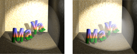

The following examples show a Light Fog applied to a Spot light using the default settings of 1.0, and the Fog Spread and Fog Intensity setting changed to 2.0.

Fog Spread
Only for spot lights.
Determines how the fog brightness varies across the spot light or point light beam. A high Fog Spread value produces fog with uniform brightness shooting from the cone of a spot light. A low Fog Spread value produces fog which is brighter at the center of the spot light beam and foggier at the end.
The slider range for a spot light is 0 to 5. The default value is 1.

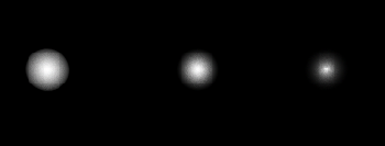

Fog Type
Only for point lights.
Select a Fog Type from the drop-down list. Fog types include:
Normal
The default fog setting.
Linear
Fog slowly diminishes from the center of the light.
Exponential
Fog quickly diminishes from the center of the light.
