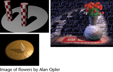

- Shadow Color
The color of shadows produced by the light. Use a colored shadow to simulate shadows produced by transparent, colored surfaces (for example, colored glass). The default setting is black.
You can also map textures to shadows to create interesting effects. The following example shows a Checker texture mapped to the Shadow Color of a Spot Light.
If you decide to map a texture that has color (such as the Stucco texture in the following example), change the texture’s color to black and white if desired.
