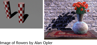

You can also map textures to shadows to create interesting effects. The following example shows a Checker texture mapped to the Shadow Color of a Spot Light.
If you decide to map a texture that has color (such as the Stucco texture in the following example), change the texture’s color to black and white if desired.
