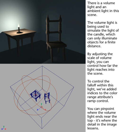

Color Range
- colorRange

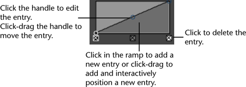

The colorRange is the color of the light from the center to the edge of the volume. By changing the values on the ramp (gradient) you can decay or change color along the defined light direction. The right side of the ramp represents the light color at the center of the volume. The left side is the color at the outer boundary. The effect of decay is accomplished by the interpolation (blend) from the inner color to the outer color. The outermost color should be black to avoid a hard boundary at the volume edge.
See Set attributes using ramps for more information on how to customize your ramp by adding additional color entries.
Tip:Advanced ramp features exist. For more information, see Ramp Shader.

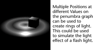

Penumbra
This section applies to cone and cylinder light shapes only. This contains attributes for managing the penumbra, the area of partial illumination around the shadow border and the light. Using the graph you can adjust the spread and the dropoff of the light. The left side of the graph represents the intensity at the outer edge of the cone or cylinder and the right side represents the intensity from the center of the beam to the edge.

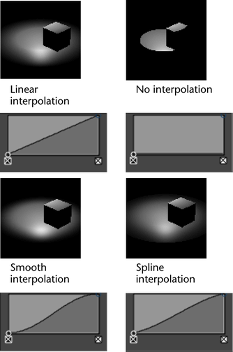

- Interpolation
This controls the way the values are calculated. Select an option from the drop-down list: None, Linear, Smooth, Spline. The default is Linear.
- None: There is no interpolation; the different values show up as different bands in the final result.
- Linear: The values are interpolated linearly.
- Smooth: The values are interpolated along a bell curve, so that each value on the ramp dominates the region around it, then blends quickly to the next value.
- Spline: This takes into account neighboring indices for a smoother effect.
