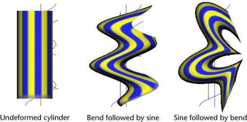

In general, you can apply as many deformers to an object as you like. By default, the order in which deformers act on a deformable object’s original shape is the order in which the deformers were created. The deformers created first act on the original shape first, and the deformers created last act on the original shape last.
Since the effects depend on the order in which the deformers deform the object, you can create a great variety of effects. For example, if you create a bend deformer and then create a sine deformer, the result is different than if you first created the sine deformer and then created the bend deformer.
