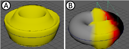

Weights Visualization menu. The deformer weight appears as a color ramp. The deformer appears as uniform yellow because it is applied uniformly to the geometry. If you use deformer falloffs you will see the falloff the falloff areas in color.
Torus with Wave deformer A. with Weights Visualization B. With Weights Visualization and a Primitive Falloff
