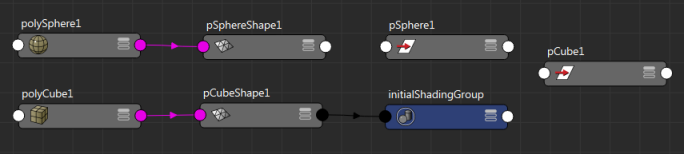

Example
- Select Options > Additive Graphing Mode to enable the Additive Graphing Mode option.
- Create a sphere and click the
button to graph its input connections. - Create a cube. With the cube selected, click the
button.
The result graph is as follows:
Only the input connections are graphed for the sphere but both the input and output connections are graphed for the cube.
