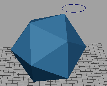

- Make sure your scene has the geometry to be deformed and a curve to act as the wire in it. (In this example, a standard poly platonic shape from the Poly
Modeling
shelf and a NURBS Circle from the
Curves shelf is used.)
A poly platonic shape and a NURBS Circle
Position the curve where you want it; once the Wire deformer is active, you can't easily reposition the curve.

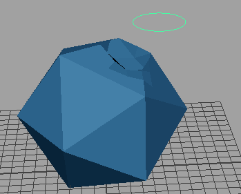

The circle "wire" makes an impression on the geometry
- In the Attribute Editor (Ctrl +
A), select the
wire1 tab. Set the Scale and Dropoff distance to the desired amount. (In this example, both settings were set to
3.0).
Result: using the circle to influence the shape of the object
- Translate, rotate, and scale the circle "wire" to deform the geometry.

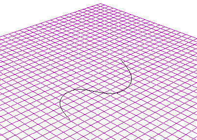

- Create a curve for an influence wire. Draw an S-shaped curve on the center area of the plane using the
CV Curve Tool or
EP Curve Tool.

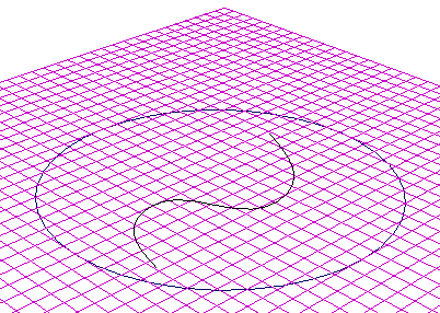

- Create a circle for limiting the deformation region. For this example, the circle surrounds the S-shaped curve on the plane.
You’ll use the circle to limit the deformation region. A curve that limits the deformation region is called a holder.

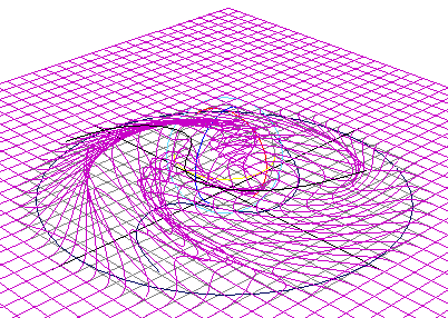

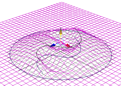

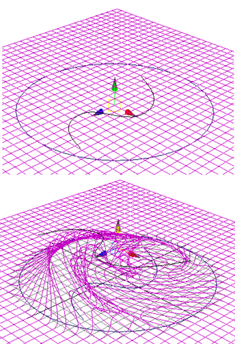

- Create deformations by doing the following:
- Select the S-shaped curve.
- Move the S-shaped curve up.
- Rotate the S-shaped curve to get a swirling “chakra” deformation effect.
The plane deforms upwards as if attracted to the S-curve.
The wire deformer uses the S-shaped curve to influence the shape of the deformation, so this curve is called an influence wire. Meanwhile, because the circle is limiting the deformation region, it’s called a holder.
