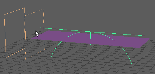

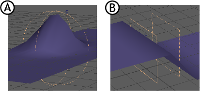

- Select the PrimitiveFalloff tab in the Attribute Editor, and edit the falloff Ramp in
Primitive Falloff Attribute settings. Switch the falloff object for either a sphere or a plane in the ramp
Primitive menu.
Note: You can choose either a sphere or a plane as the falloff object. The shape type governs the behavior of the falloff. Choose Sphere (B) to have the falloff occur from the center of the sphere to its outer edge, and choose Plane (A) if you want a two-dimensional falloff effect. When using a plane falloff object, the falloff effect occurs in the space between the two planes.
If you prefer to use your own geometry as a falloff object, see Proximity Falloff, below.

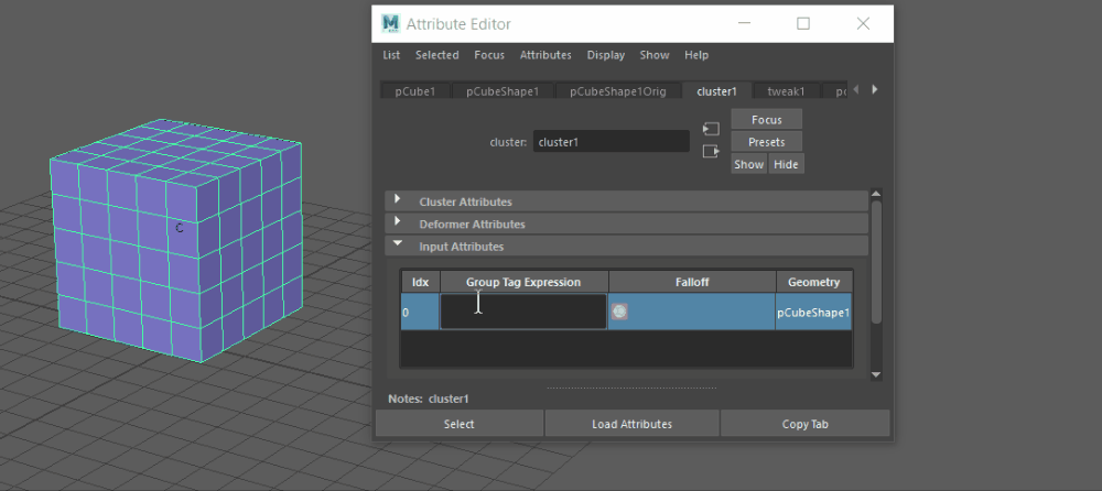

- Uniform falloff: Create consistent falloff effects
- The Uniform falloff is a simple falloff that lets you apply a even falloff effect to geometry.
- Select geometry and add a deformer.
- In the Attribute Editor, select the <defomername> tab and expand the Deformer Attributes widget.
- Right-click the
Component Tag column, and select
Note: You can still apply Falloff effects for deformers if you do not have any Component Tags assigned to the geometry. Component Tags let you create sub-sections of geometry. See Assign Component Tags to geometry.
- Right-click the Falloff and choose Select Falloff. A new UniformFalloff1 tab is added to the Attribute Editor.
- In the UniformFalloff1 tab, expand the Extra Attributes section to expose the Uniform Weight field.
- Enter a value for the deformation falloff in the Uniform Weight field.
A weight value of 1.00 means 100% deformation, that is, there is full deformation and no falloff effect, while a weight value of 0 erases the deformation effect. Increasing the value over 1.0 amplifies the deformation.

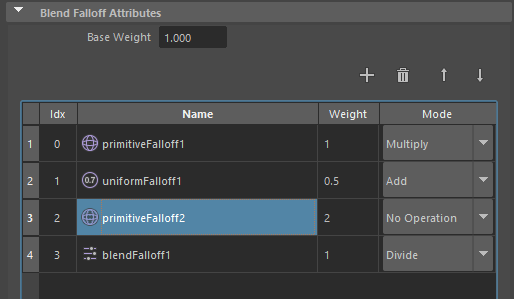

- In the Falloff column again, right-click Blend Falloff and choose Select Falloff. The Attribute Editor switches to the Blend Falloff 1 tab.
- In the
Blend Falloff widget in the Attribute Editor, click the
Add New Assignment
icon above the
Blend Falloff Attributes widget. A new row is added.
- Right-click in the name field and choose a falloff you wish to blend from the right-click menu. Be careful to choose an existing falloff in the scene and not create a new falloff effect.
- Keep adding falloffs from the scene in new rows.
- Select how the falloffs are blended using the
Mode menus for each row:
- You can multiply, divide, add, subtract, override and max each falloff
- Right-click the Weight field to create a new expression or texture, lock or key the attribute.
See Blend Falloff attributes topic for more information.
Note: You can reorder the falloffs in the Blend Falloff Attributes table, by selecting a row and using the move up or move down icons above the table. The last falloff in the table has precedence over the falloffs in the table before it, as it is the last falloff added. - Proximity Falloff: Controlling effects with custom geometry

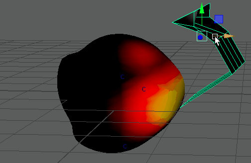

A Proximity Falloff with Weights Visualization active
- Use the Proximity Falloff to use proximity of geometry as a method to create the falloff effect.
- In the Attribute Editor, select the <deformername> tab and expand the Deformer Attributes widget.
- Right-click the Component Tag column, and select .

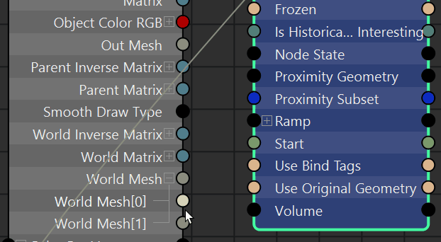

- Open the Node Editor, locate the <shape1> node of the object you want to use as a deformation influence and the ProximityFalloff1 node.
- Connect the World Mesh 0 of the influence object to the Proximity Geometry object the ProximityFalloff node.
- (optional) To view the influence of the Falloff Object, right-click the Falloff tab in the Attribute Editor, and select Weights Visualization.

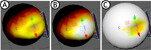

- Select the
Proximity Falloff tab in the
Attribute Editor, and choose
Inside,
Outside, or
None from the
Volume menu to set how the geometry mass influences the falloff effect. See
Proximity Falloff attributes for information on the settings.
Cone Primitive Falloff Object: Volume set to A. None, B. Inside, and C. Outside.

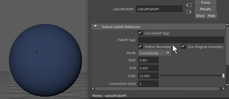

- Subset falloff: deformation applied to Component Tags
- Use the Subset falloff to limit deformation to subsets of geometry, defined by Component Tags.
- Right-click the Falloff column, and select .
- Double-click the SubsetFalloff1 cell in the Falloff column of the Deformer Attributes table. The Attribute Editor shows the Subset falloff attributes.
- Turn on Use Falloff Tags. If this option is not activated, the deformation is applied to the deformation membership.
- Add the name(s) of the
Component Tag(s) that you want to use for the deformation in the
Falloff Tags field and press
Enter. The
Falloff Tags field supports regular expressions to simplify adding Component Tag(s).
- Adjust the Subset Falloff Attributes to control how the deformation is applied and what method to calculate values. See Subset falloff attributes for information on the settings.
- (optional) To better view the falloff influence, right-click the Falloff tab in the Deformer Attributes widget in the Attribute Editor, and select Weights Visualization.
