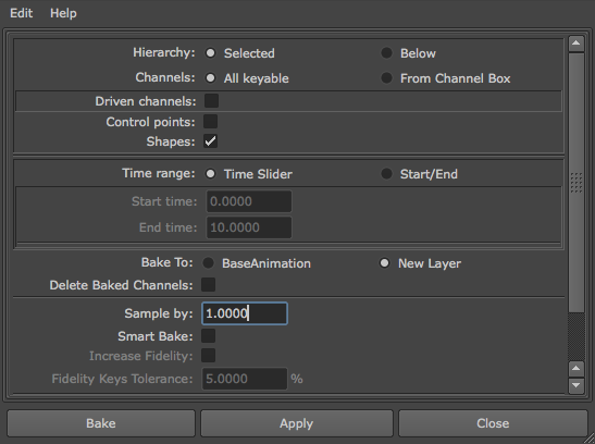

- In the
Bake Simulation Options window, select the bake options you want to use. For example:
- Use the Bake To options to specify whether you want the animation baked to the BaseAnimation, or to a new layer.
- Set
Baked layers to
Remove Attributes if you want the selected object’s attributes removed from any associated layers after their animation is baked.
Attention: When Baked layers is set to Remove Attributes, the selected object’s keys are removed from any associated layer that is not muted. If your workflow is to use layers like takes, mute all layers with keys that you want to preserve before baking layers.
- Turn Smart Bake on if you do not need your result animation to have one key per frame.
- Click
Bake.
