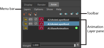

To access the Animation Layer Editor:
- Switch to the Anim tab below the Channel Box.
- To open the Animation Layer Editor as a separate window, switch to the Anim tab at the bottom of the Channel Box, then select from the Animation Layer Editor menu bar.
The Animation Layer Editor contains the menu bar, toolbar, and animation layer pane.
