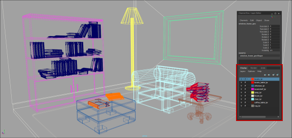

You can assign different wireframe colors to objects to make them easier to keep track of in the view panels. The wireframe color can be assigned per object, or per display layer, as shown here.

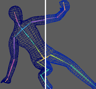

Note: There is a known issue where the wireframe color may lighten when keying deformer attributes if GPU Override and Color Management are enabled. This problem only affects the wireframe color, it does not affect animation or deformation. To stop this from occurring, turn off GPU Override in the Animation (Settings) Preferences or Color Management in the Color Management Preferences.
Occasionally the wireframe color may appear lighter; this does not affect performance

Change the wireframe color of all objects in a layer
In the Display Layer Editor, click the color button beside a layer name to open the Edit Layer window.
Choose RGB from the drop-down list to assign full RGB colors to the object's wireframe, or select Index and select a preset color from the palette.
The layer's wireframe color overrides that of the individual objects in that layer.
