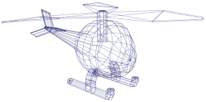

Wireframe |
Press 4 or Click the
or Choose in the view panel. |

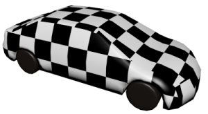

Shaded with hardware-rendered textures |
Press 6 or When Smooth Shade All is on: Click the
or Choose |

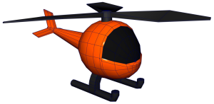

Wireframe on Shaded |
or Choose |

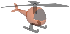

X-Ray mode |
X-Ray shading automatically displays objects with slight transparency to let you see and select things behind opaque surfaces. There are three X-Ray display modes:
Tip: Use
Alt +
A to toggle through all these modes.

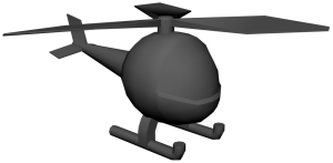

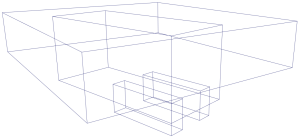

Bounding box |
Choose |

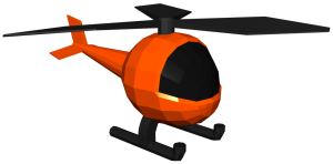

Flat (faceted) shading |
Choose or Flat Shade Selected Items |

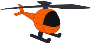

Constant shading |
Select . You can also turn on to see the geometry wireframe on the objects. |
