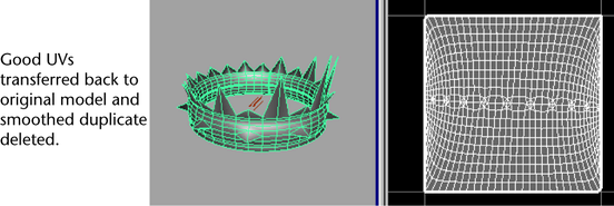

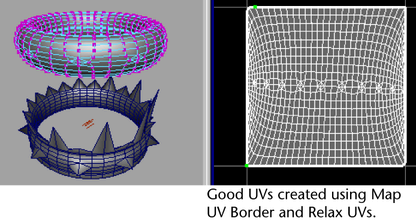

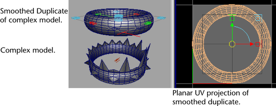

- Transfer a finished UV layout, including multiple UV sets, from one surface mesh to another mesh that has no existing UVs.
- Transfer a UV layout from a high resolution model to a low resolution version.
