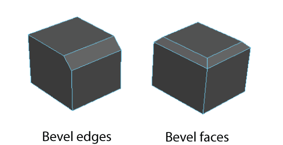

Bevels expand each selected edge into a new face, rounding the edges of a polygon mesh. See Bevel command.
To bevel edges or faces
- Select a mesh object or select the edges or faces you want to bevel.
Note: If you select a mesh object, Maya bevels every edge in the mesh.

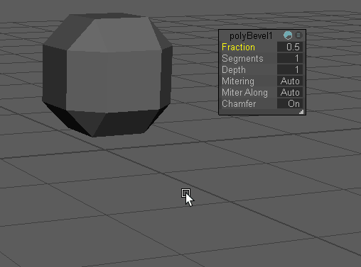

- In the
In-View Editor that appears, adjust the
polyBevel attributes.
Tip: Select an attribute in the marking menu (Ctrl + Shift + Right-click) to make your selection the active attribute in the In-View Editor. You can cycle through the list of attributes using Ctrl + Tab (cycles from the bottom of the list to the top) or Ctrl + Shift + Tab (cycles from the top of the list to the bottom).
