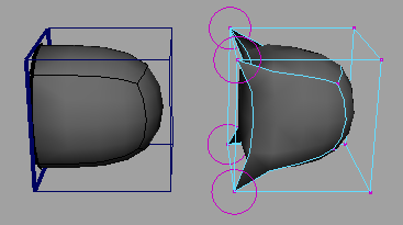

You can select more than one edge or vertex at a time on a mesh to crease. You can also select items on more than one polygon object and crease all of the items simultaneously. However, you may experience crease popping.

Edges that have creasing applied appear with heavier lines on the original mesh. Vertices with creasing applied are indicated by a small circle encompassing the vertex.
