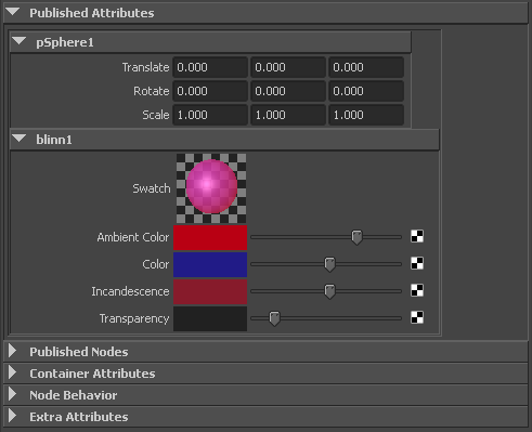

Open the asset in the Attribute Editor to see that the swatch now appears in the Published Attributes section. Modify attributes related to the shader to update the swatch accordingly.
