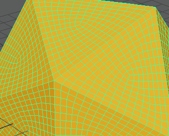

You can select components such as vertices or faces by painting over the components ( with your graphics tablet pen.
- Select the object on which you want to select components.
Right-click geometry and choose components
- Double-click the
Paint Selection Tool
in the
Toolbox.
- Use the
Tool Settings panel to set up the tool, including the brush size and choosing whether you are selecting, deselecting, or toggling components between selected and unselected. If you are using a graphics tablet pen, you can activate
Stylus Pressure.
Tip: B + drag to resize the brush radius.
- Set up the selection mask to select what types of components you want to select.
- Paint on the selected object to select components.
