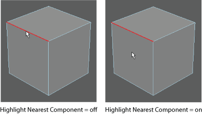

By default, Highlight Nearest Component is turned on in the Modeling Toolkit and the Select Tool settings. When Highlight Nearest Component is turned off, components are highlighted only when your cursor is placed on top of them.
Tip: Disable Highlight backfaces in the Tool Settings to highlight only those components that are facing the camera.
